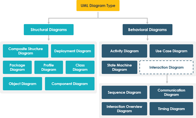

Overview of the 14 UML Diagram Types

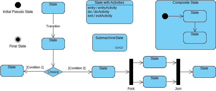

Components of a UML State Diagram
UML state diagrams use symbols that you may have seen in UML activity diagrams.
  • Start state: solid circle.
  • End state: solid circle with rounded corners.
  • State: rectangle with rounded corners with the name of the action.
  • Transition: Connected arrow with label indicating the trigger for that transition (if any).
  • States with internal activity: States with horizontal lines whose behavior is listed in the lower half.
  • Composite states: states with horizontal lines and nested state diagrams (or links to another draw.io page) in the lower half.
  • Guards or conditions: Diamonds.
  • Fork: A thicker line with one transition input and two or more outputs.
  • Join: A thicker line with more than one transition input and only one transition.

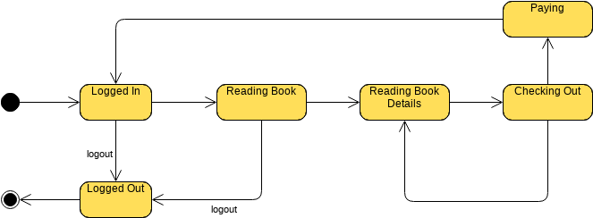

UML state diagram example – Online Bookshop
