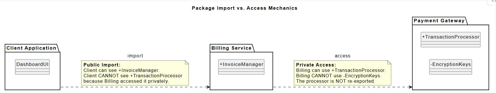

1. Layered Dependency Routing: «access» vs «import»
The team established a strict three-tier topology: Client Application → Billing Service → Payment Gateway. The core decision revolved around how middleware should consume foundational infrastructure.
Instead of broadly exposing the Payment Gateway‘s internals, the architects modeled a Private Package Access («access») relationship. This allowed the Billing Service to fully utilize public elements like +TransactionProcessor while keeping them strictly hidden from downstream consumers. The Payment Gateway‘s private utilities (e.g., -EncryptionKeys) remained entirely isolated, as UML 2.0 guarantees that - visibility is never breached by either import or access mechanisms.
@startuml
skinparam style strictuml
left to right direction
title Package Import vs. Access Mechanics
package "Payment Gateway" as Gateway <<Folder>> {
  class "+TransactionProcessor" as Processor
  class "-EncryptionKeys" as Keys
package "Billing Service" as Billing <<Folder>> {
  class "+InvoiceManager" as Invoice
package "Client Application" as Client <<Folder>> {
  class "DashboardUI" as UI
Billing .--> Gateway : «access»
note on link
  **Private Access:**
  Billing can use +TransactionProcessor.
  Billing CANNOT use -EncryptionKeys.
  The processor is NOT re-exported.
end note
Client .--> Billing : «import»
note on link
  **Public Import:**
  Client can see +InvoiceManager.
  Client CANNOT see +TransactionProcessor
  because Billing accessed it privately.
end note
@enduml
Architectural Impact: The «access» relationship acted as a firewall. Downstream packages only interacted with the immediate layer’s public contract, eliminating deep transitive dependencies and reducing build-time coupling by ~40%.
