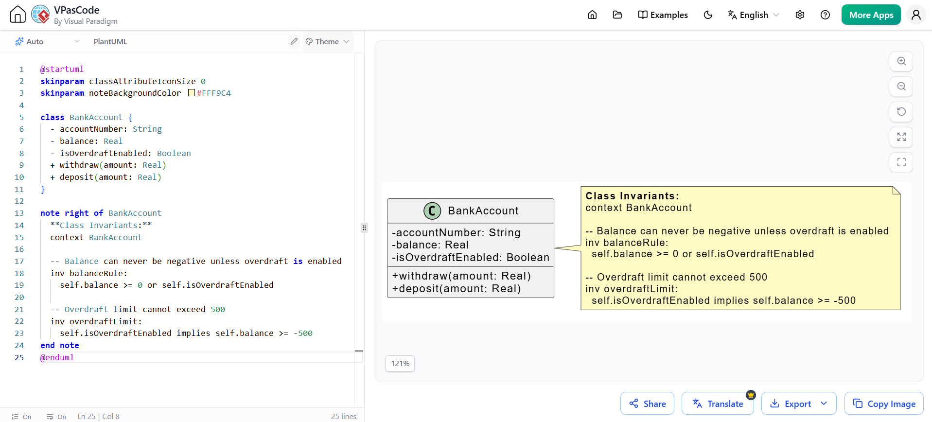

A. Class Invariants (inv)
Invariants are conditions that must always be true for every instance of a class, regardless of what operations are called.
Key Concept: If an invariant is violated, the system is in an invalid state.
@startuml
skinparam classAttributeIconSize 0
skinparam noteBackgroundColor #FFF9C4
class BankAccount {
  - accountNumber: String
  - balance: Real
  - isOverdraftEnabled: Boolean
  + withdraw(amount: Real)
  + deposit(amount: Real)
note right of BankAccount
  **Class Invariants:**
  context BankAccount
  -- Balance can never be negative unless overdraft is enabled
  inv balanceRule:
    self.balance >= 0 or self.isOverdraftEnabled
  -- Overdraft limit cannot exceed 500
  inv overdraftLimit:
    self.isOverdraftEnabled implies self.balance >= -500
end note
@enduml

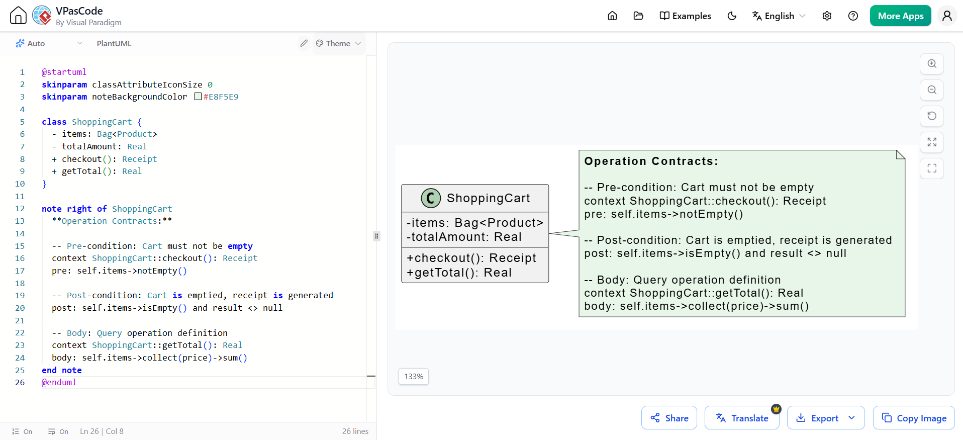

@startuml
skinparam noteBackgroundColor #E8F5E9
class ShoppingCart {
  - items: Bag<Product>
  - totalAmount: Real
  + checkout(): Receipt
  + getTotal(): Real
note right of ShoppingCart
  **Operation Contracts:**
  -- Pre-condition: Cart must not be empty
  context ShoppingCart::checkout(): Receipt
  pre: self.items->notEmpty()
  -- Post-condition: Cart is emptied, receipt is generated
  post: self.items->isEmpty() and result <> null
  -- Body: Query operation definition
  context ShoppingCart::getTotal(): Real
  body: self.items->collect(price)->sum()
end note
@enduml

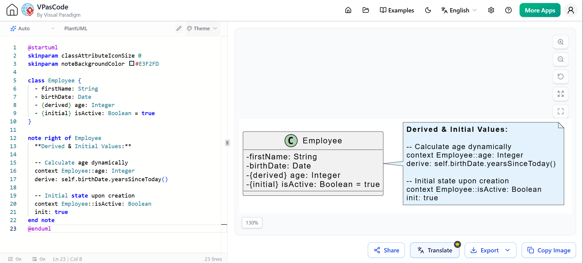

C. Derived and Initial Values (derive, init)
Instead of storing redundant data, UML allows attributes to be marked as {derived} or {initial}, with OCL defining their exact value.
@startuml
skinparam noteBackgroundColor #E3F2FD
class Employee {
  - firstName: String
  - birthDate: Date
  - {derived} age: Integer
  - {initial} isActive: Boolean = true
note right of Employee
  **Derived & Initial Values:**
  -- Calculate age dynamically
  context Employee::age: Integer
  derive: self.birthDate.yearsSinceToday()
  -- Initial state upon creation
  context Employee::isActive: Boolean
  init: true
end note
@enduml

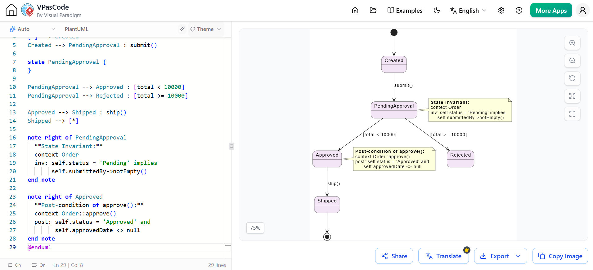

D. State Machine Guards
In State Machine diagrams, transitions can have guards—boolean expressions that must evaluate to true for the transition to occur. OCL is the standard language for writing these guards.
@startuml
skinparam stateBackgroundColor #F3E5F5
[*] --> Created
Created --> PendingApproval : submit()
state PendingApproval {
PendingApproval --> Approved : [total < 10000]
PendingApproval --> Rejected : [total >= 10000]
Approved --> Shipped : ship()
Shipped --> [*]
note right of PendingApproval
  **State Invariant:**
  context Order
  inv: self.status = 'Pending' implies
       self.submittedBy->notEmpty()
end note
note right of Approved
  **Post-condition of approve():**
  context Order::approve()
  post: self.status = 'Approved' and
        self.approvedDate <> null
end note
@enduml

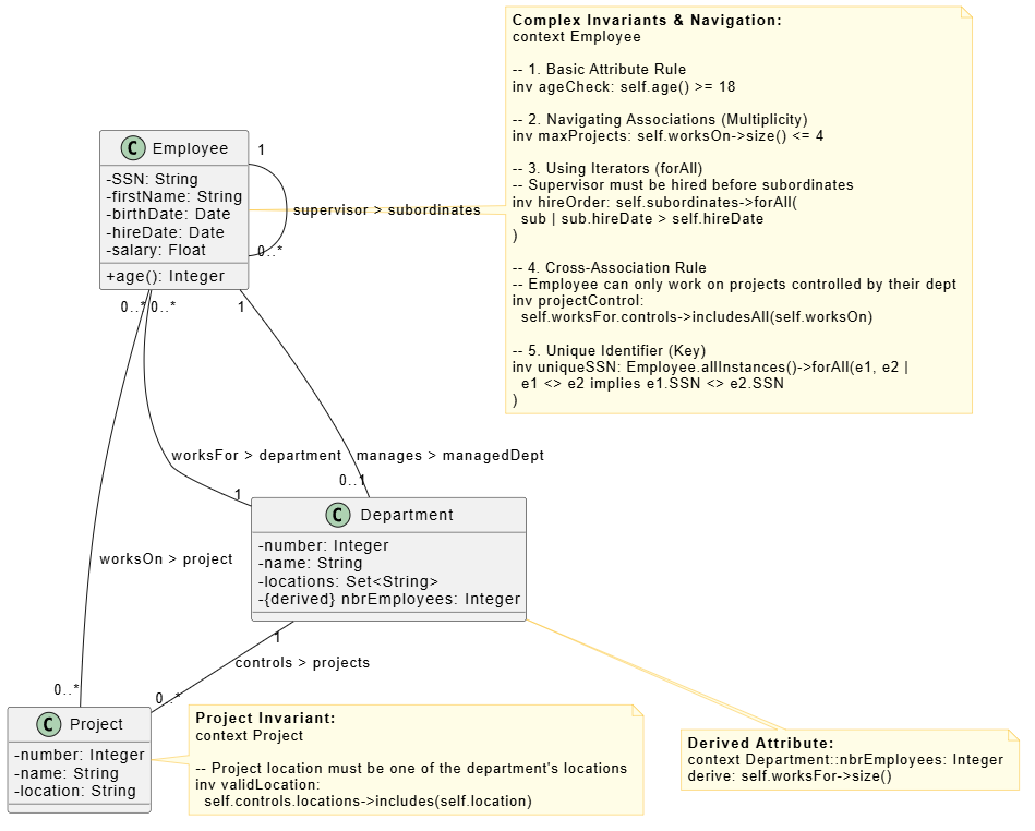

3. Comprehensive Case Study: The Company Model
Let’s apply OCL to a complex UML Class Diagram involving Employee, Department, and Project. This demonstrates how OCL navigates associations and uses collection iterators (select, forAll, size).
@startuml
skinparam noteBackgroundColor #FFFDE7
skinparam noteBorderColor #FBC02D
class Employee {
  - SSN: String
  - firstName: String
  - birthDate: Date
  - hireDate: Date
  - salary: Float
  + age(): Integer
class Department {
  - number: Integer
  - name: String
  - locations: Set<String>
  - {derived} nbrEmployees: Integer
class Project {
  - number: Integer
  - name: String
  - location: String
Employee "0..*" -- "1" Department : worksFor > department
Employee "0..*" -- "0..*" Project : worksOn > project
Employee "1" -- "0..1" Department : manages > managedDept
Department "1" -- "0..*" Project : controls > projects
Employee "1" -- "0..*" Employee : supervisor > subordinates
  **Complex Invariants & Navigation:**
  context Employee
  -- 1. Basic Attribute Rule
  inv ageCheck: self.age() >= 18
  -- 2. Navigating Associations (Multiplicity)
  inv maxProjects: self.worksOn->size() <= 4
  -- 3. Using Iterators (forAll)
  -- Supervisor must be hired before subordinates
  inv hireOrder: self.subordinates->forAll(
    sub | sub.hireDate > self.hireDate
  -- 4. Cross-Association Rule
  -- Employee can only work on projects controlled by their dept
  inv projectControl:
    self.worksFor.controls->includesAll(self.worksOn)
  -- 5. Unique Identifier (Key)
  inv uniqueSSN: Employee.allInstances()->forAll(e1, e2 |
    e1 <> e2 implies e1.SSN <> e2.SSN
end note
note bottom of Department
  **Derived Attribute:**
  context Department::nbrEmployees: Integer
  derive: self.worksFor->size()
end note
note right of Project
  **Project Invariant:**
  context Project
  -- Project location must be one of the department's locations
  inv validLocation:
    self.controls.locations->includes(self.location)
end note
@enduml

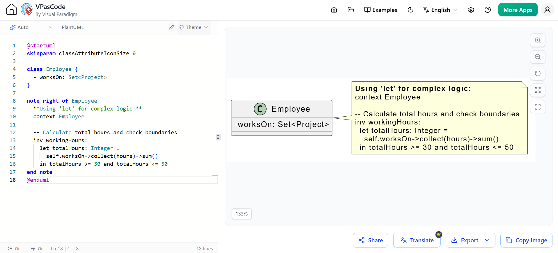

A. Using let for Readability
When an OCL expression becomes too complex, use the let keyword to define local variables within the constraint. This makes the UML note much easier to read.
@startuml
class Employee {
  - worksOn: Set<Project>
  **Using 'let' for complex logic:**
  context Employee
  -- Calculate total hours and check boundaries
  inv workingHours:
    let totalHours: Integer =
      self.worksOn->collect(hours)->sum()
    in totalHours >= 30 and totalHours <= 50
end note
@enduml

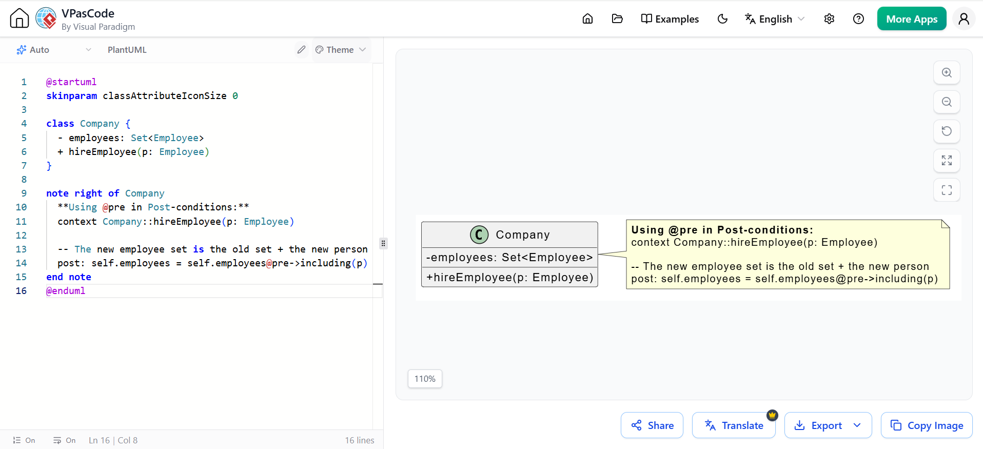

B. Handling Previous Values in Post-conditions (@pre)
When defining a post-condition, you often need to compare the new state with the old state. OCL uses the @pre postfix to access the value of a property exactly as it was before the operation started.
@startuml
class Company {
  - employees: Set<Employee>
  + hireEmployee(p: Employee)
note right of Company
  **Using @pre in Post-conditions:**
  context Company::hireEmployee(p: Employee)
  -- The new employee set is the old set + the new person
  post: self.employees = self.employees@pre->including(p)
end note
@enduml
