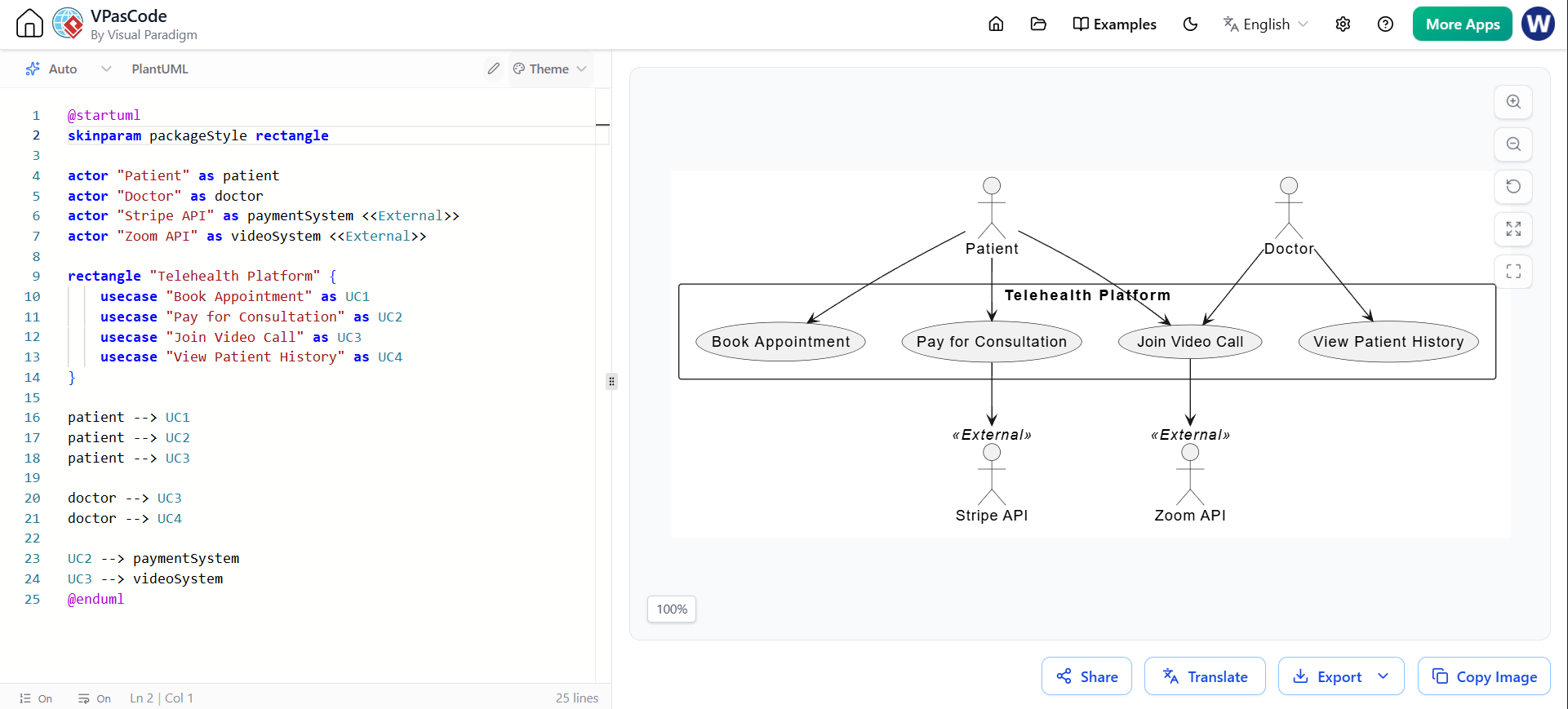

Realistic Example: Telehealth Context
Let’s map out the high-level view of our Telehealth platform.
PlantUML Implementation
@startuml
skinparam packageStyle rectangle
actor "Patient" as patient
actor "Doctor" as doctor
actor "Stripe API" as paymentSystem <<External>>
actor "Zoom API" as videoSystem <<External>>
rectangle "Telehealth Platform" {
    usecase "Book Appointment" as UC1
    usecase "Pay for Consultation" as UC2
    usecase "Join Video Call" as UC3
    usecase "View Patient History" as UC4
patient --> UC1
patient --> UC2
patient --> UC3
doctor --> UC3
doctor --> UC4
UC2 --> paymentSystem
UC3 --> videoSystem
@enduml

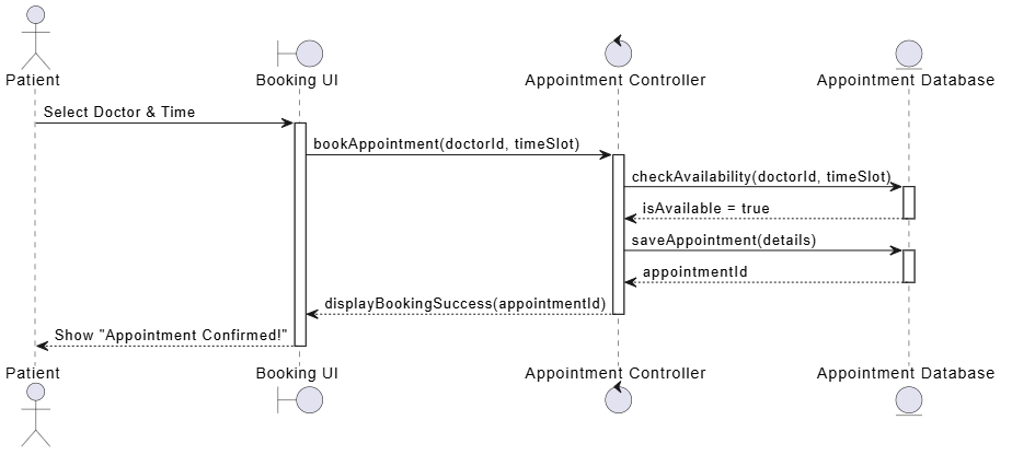

Realistic Example: Booking an Appointment
Let’s trace the “Book Appointment” use case to see how the Patient interacts with the system.
@startuml
actor Patient
boundary "Booking UI" as UI
control "Appointment Controller" as Controller
entity "Appointment Database" as DB
Patient -> UI : Select Doctor & Time
activate UI
UI -> Controller : bookAppointment(doctorId, timeSlot)
activate Controller
Controller -> DB : checkAvailability(doctorId, timeSlot)
activate DB
DB --> Controller : isAvailable = true
deactivate DB
Controller -> DB : saveAppointment(details)
activate DB
DB --> Controller : appointmentId
deactivate DB
Controller --> UI : displayBookingSuccess(appointmentId)
deactivate Controller
UI --> Patient : Show "Appointment Confirmed!"
deactivate UI
@enduml

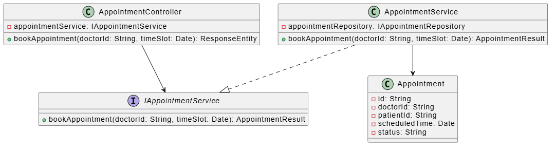

Realistic Example: The Appointment Blueprint
Based on our sequence diagram, we need an interface for the service, a controller to handle the web requests, and an entity to hold the data.
@startuml
interface IAppointmentService {
    + bookAppointment(doctorId: String, timeSlot: Date): AppointmentResult
class AppointmentController {
    - appointmentService: IAppointmentService
    + bookAppointment(doctorId: String, timeSlot: Date): ResponseEntity
class AppointmentService {
    - appointmentRepository: IAppointmentRepository
class Appointment {
    - id: String
    - doctorId: String
    - patientId: String
    - scheduledTime: Date
    - status: String
AppointmentController --> IAppointmentService
AppointmentService ..|> IAppointmentService
AppointmentService --> Appointment
@enduml
