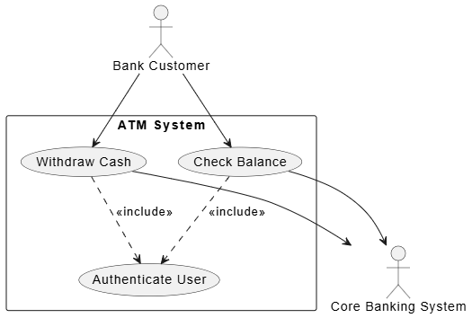

A. Use Case Relationship Diagram
This diagram maps actor interactions, defines system boundaries, and illustrates inclusion relationships between reusable behaviors.
@startuml
skinparam theme plain
skinparam packageStyle rectangle
actor "Bank Customer" as customer
actor "Core Banking System" as bank
rectangle "ATM System" {
    usecase "Withdraw Cash" as UC_Withdraw
    usecase "Check Balance" as UC_Balance
    usecase "Authenticate User" as UC_Auth
    ' Inclusion relationship
    UC_Withdraw ..> UC_Auth : <<include>>
    UC_Balance ..> UC_Auth : <<include>>
customer --> UC_Withdraw
customer --> UC_Balance
UC_Withdraw --> bank
UC_Balance --> bank
@endum

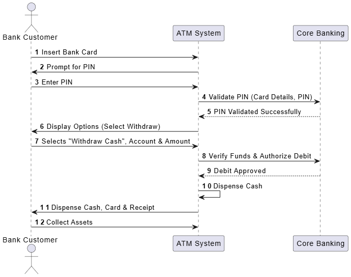

B. Sequence Diagram for the Main Success Scenario
This diagram translates the Main Success Scenario (withdraw cash use case) into a chronological timeline, clarifying message flow, synchronization points, and system-to-system handoffs.
@startuml
autonumber
actor "Bank Customer" as Customer
participant "ATM System" as ATM
participant "Core Banking" as Bank
Customer -> ATM : Insert Bank Card
ATM -> Customer : Prompt for PIN
Customer -> ATM : Enter PIN
ATM -> Bank : Validate PIN (Card Details, PIN)
Bank --> ATM : PIN Validated Successfully
ATM -> Customer : Display Options (Select Withdraw)
Customer -> ATM : Selects "Withdraw Cash", Account & Amount
ATM -> Bank : Verify Funds & Authorize Debit
Bank --> ATM : Debit Approved
ATM -> ATM : Dispense Cash
ATM -> Customer : Dispense Cash, Card & Receipt
Customer -> ATM : Collect Assets
@enduml
