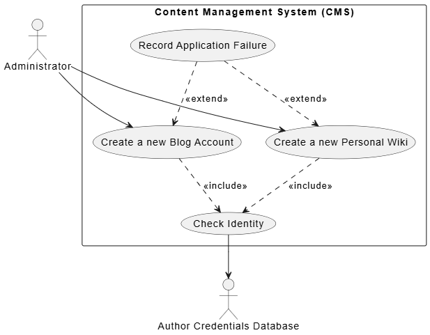

1. The <<include>> Relationship: Enforcing Behavioral Reuse
Purpose & Mechanism
The <<include>> relationship exists to eliminate redundancy. When multiple use cases share identical procedural steps, those steps are extracted into a standalone sub-use case. The base use case explicitly incorporates this shared behavior, ensuring that the included steps are always executed as part of the primary flow.
Crucially, the included use case does not require a direct actor association. It automatically inherits the contextual connection from whichever base use case invokes it, keeping the diagram clean and focused on business goals rather than implementation minutiae.
PlantUML Visualization
In PlantUML, a dashed dependency arrow points from the base use case to the included use case.
@startuml
skinparam theme plain
skinparam packageStyle rectangle
actor Administrator as admin
actor :Author Credentials Database: as db
rectangle "Content Management System (CMS)" {
    ' Include Example
    usecase "Create a new Blog Account" as UC_Blog
    usecase "Create a new Personal Wiki" as UC_Wiki
    usecase "Check Identity" as UC_Check
    UC_Blog ..> UC_Check : <<include>>
    UC_Wiki ..> UC_Check : <<include>>
    ' Extend Example
    usecase "Record Application Failure" as UC_Fail
    UC_Fail ..> UC_Blog : <<extend>>
    UC_Fail ..> UC_Wiki : <<extend>>
admin --> UC_Blog
admin --> UC_Wiki
UC_Check --> db
@enduml
Textual Documentation Mapping
Instead of rewriting identity validation steps across multiple specifications, the team adopted a standardized inclusion syntax in the main success flow:
Use Case Field Value / Flow Steps
Use Case Name Create a new Blog Account
Main Success Flow 1. Administrator selects account type.
2. Administrator enters author’s details.
3. include::Check Identity to verify author.
4. System creates the new blog account.

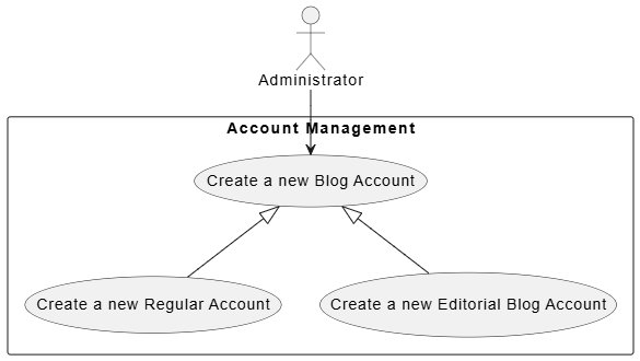

2. Use Case Generalization (Inheritance): Managing Specialized Variations
Purpose & Mechanism
Generalization is applied when a base use case defines a core workflow that applies to multiple specialized contexts, each requiring only minor deviations. A child use case inherits all behaviors, goals, and relationships of its parent. Only the unique or overridden steps need to be documented in the child.
The “All-or-Nothing” Rule: Inheritance in use cases is strict. Every step defined in the parent must logically execute in the child. If a specialized scenario requires skipping or fundamentally altering a parent step, generalization is the wrong tool.
Generalization uses a solid line with a hollow arrowhead, pointing from the child to the parent.
@startuml
rectangle "Account Management" {
    usecase "Create a new Blog Account" as UC_Parent
    usecase "Create a new Regular Account" as UC_Regular
    usecase "Create a new Editorial Blog Account" as UC_Editorial
    ' Generalization arrows pointing to Parent
    UC_Parent <|-- UC_Regular
    UC_Parent <|-- UC_Editorial
admin --> UC_Parent
@enduml
3. The <<extend>> Relationship: Capturing Conditional & Optional Flows
Purpose & Mechanism
Unlike <<include>>, which represents mandatory reuse, <<extend>> models optional or conditional behavior that only triggers under specific runtime circumstances. The base use case remains fully functional on its own; the extending use case acts as a runtime “hook” that injects additional steps when predefined conditions are met.
Architecturally, this separates core success paths from exception handling, alternative routing, or optional add-ons, preventing bloated primary flows.
Extensions are typically mapped directly out of the alternative or exception flows in the textual specification:
Failed End Condition The application for a new blog account is rejected.
Extensions Section Step 3.1: Author Credentials Database does not verify details.
Step 3.2: extended by::Record Application Failure.
