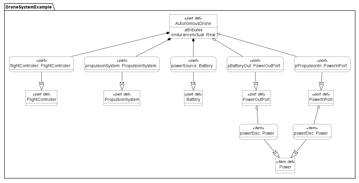

package DroneSystemExample {
private import ScalarValues::*;
private import SI::*;
// Base Blueprints (Definitions)
item def Power;
port def PowerOutPort {
out item powerElec : Power;
port def PowerInPort {
in item powerElec : Power;
part def FlightController;
part def PropulsionSystem;
part def Battery;
// Integrated System Context
part def AutonomousDrone {
// Attributes / Value properties
attribute enduranceActual : Real;
// Sub-part Usages (Instantiating the definitions)
part flightController : FlightController;
part propulsionSystem : PropulsionSystem;
part powerSource : Battery;
// Port Usages (Instantiating the interfaces)
port pBatteryOut : PowerOutPort;
port pPropulsionIn : PowerInPort;

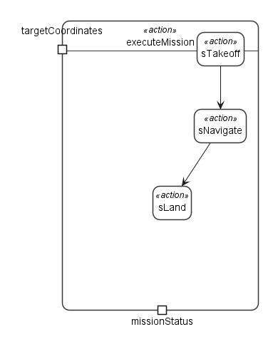

4. The Behavior Pillar (Execution Space)
SysML v1 forced a clean split between structure (Internal Block Diagrams) and behavior (Activity Diagrams). SysML v2 completely removes this barrier by making actions and control flows native, in-scope structural elements.
Sequential Actions and Control Flow
Using the action keyword, you can declare functions that accept inputs (in) and pass outputs (out). Control flows are written linearly using the then keyword, eliminating the need for complex control flow diagrams.
action executeMission {
in targetCoordinates;
out missionStatus;
action sTakeoff;
then action sNavigate;
then action sLand;

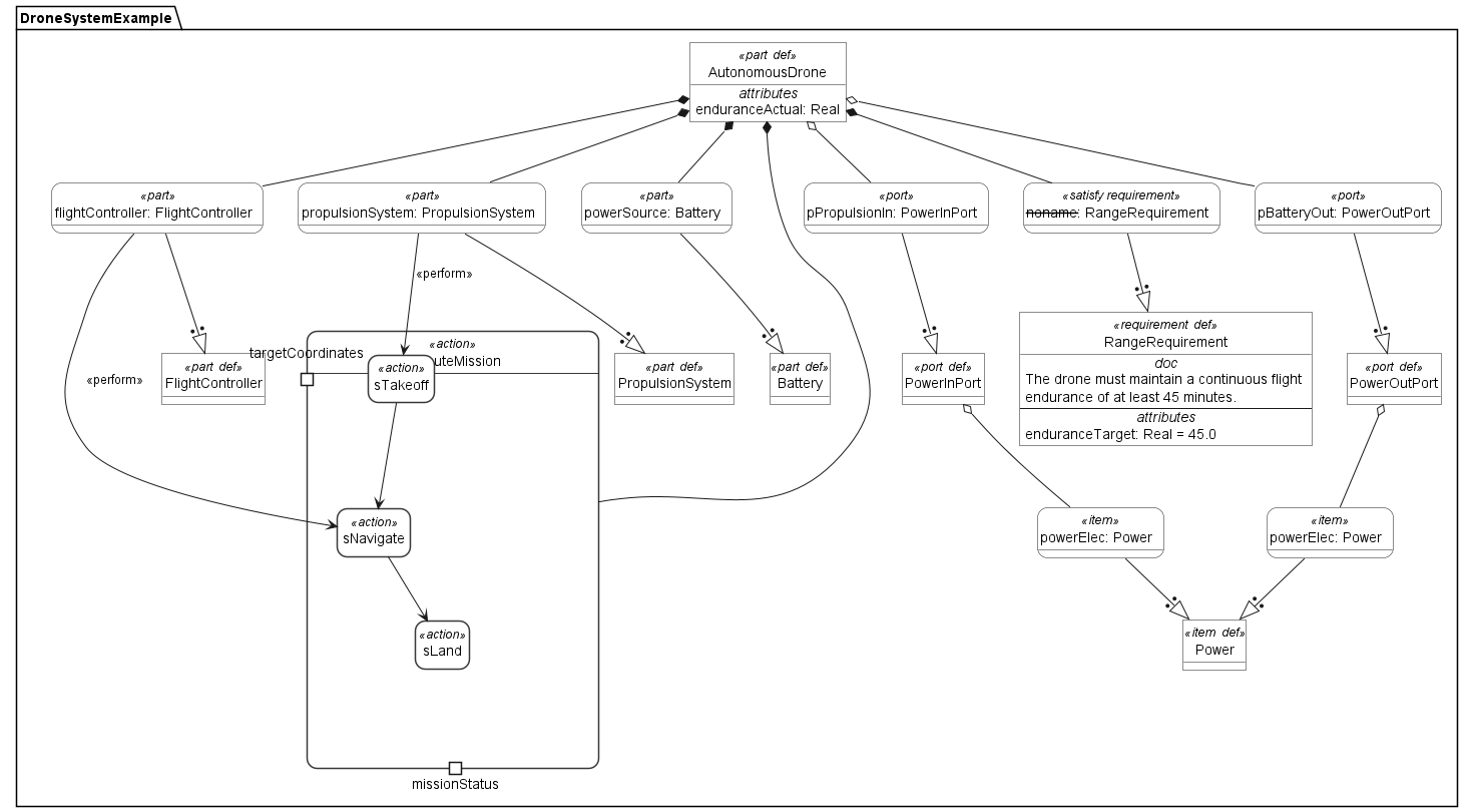

5. Functional Allocation: Connecting Behavior to Structure
Allocation answers the fundamental systems engineering question: Which component performs which function?
SysML v2 handles this cleanly using the perform keyword within a part usage block. Using Dot Notation (.), you can reach deep into nested action loops to map operations directly to physical hardware.
// Sub-parts allocate behavior by explicitly 'performing' their assigned steps
part flightController : FlightController {
perform executeMission.sNavigate;
part propulsionSystem : PropulsionSystem {
perform executeMission.sTakeoff;
// Embedded behavior definition
action sTakeoff;
then action sLand;

Full Example of the SysML V2: Three Pillars
// BASE BLUEPRINT DEFINITIONS
item def Power;
part def Battery;
// 1. REQUIREMENT PILLAR (Problem Space)
requirement def RangeRequirement {
doc /* The drone must maintain a continuous flight endurance of at least 45 minutes. */
attribute enduranceTarget : Real = 45.0;
// 2. STRUCTURE & BEHAVIOR PILLARS
// Sub-parts allocate behavior by explicitly ‘performing’ their assigned steps
// Interface connections
// FIX 1: Instantiates a requirement usage to satisfy the definition mapping cleanly
satisfy requirement : RangeRequirement;
// 3. BEHAVIOR PILLAR (Execution Space)
// Clean, sequential action definitions natively in-scope
out missionStatus;
action sTakeoff;
then action sLand;
